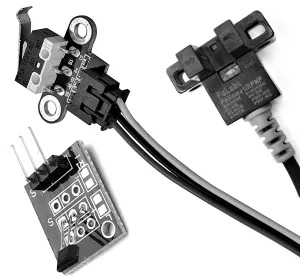

Selecting the right homing sensor can have a big impact on accuracy, dependability, and overall cost. Here is a quick rundown of the three main types (Figure 1):
Magnetic, mechanical, and optical homing sensors are available in standard configurations.
Figure 1. Magnetic, mechanical, and optical homing sensors are available
Mechanical homing sensors: These operate through contact-direct switches or levers to determine position.
  • Advantages: Straightforward, budget-friendly, and easy to install.
  • Drawbacks: Prone to wear over time, slower to respond, and less accurate.
Magnetic homing sensors: Relying on magnetic fields, often via Hall effect sensors, these do not require physical contact.
  • Advantages: Long-lasting, effective in harsh environments, and maintenance-free.
  • Drawbacks: Can be affected by magnetic interference and usually offer slightly less resolution than optical sensors.
Optical homing sensors: These use infrared light paired with slotted discs or reflective surfaces for detection.
  • Advantages: Extremely precise, quick response time, and no mechanical degradation.
  • Drawbacks: Sensitive to dust and misalignment and typically come at a higher cost.
In clean, high-precision applications like 3D printers or CNC machines, optical sensors shine. For more demanding or industrial environments, magnetic sensors often strike the right balance. And if simplicity and low cost are top priorities, mechanical sensors remain a solid choice.

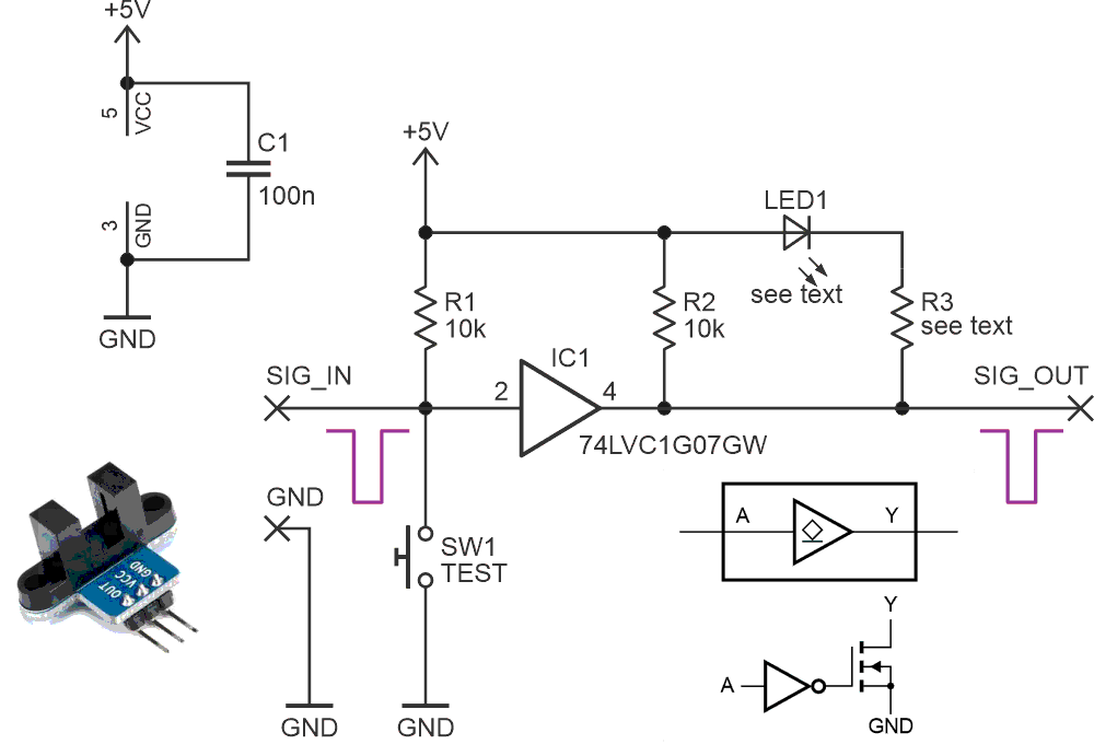

We will start with a clean, simplified schematic of the universal homing sensor adapter module shown in Figure 2. Designed for broad compatibility, it accepts logic-level inputs – including both CMOS and TTL-compatible signals – from nearly any homing sensor head, whether it’s mechanical, magnetic, or optical, making it a flexible choice for diverse applications.
A minimalistic design highlights the inherent simplicity of constructing a universal homing sensor module.
Figure 2. A minimalistic design highlights the inherent simplicity of constructing a universal homing sensor module.
The circuit is simple, economical, and built using easily sourced, budget-friendly components. True to form, the onboard test button (SW1) mirrors the function of a mechanical homing sensor, offering a convenient stand-in for setup and troubleshooting tasks.
The 74LVC1G07 (IC1) is a single buffer with an open-drain output. Its inputs accept signals from both 3.3 V and 5 V devices, enabling seamless voltage translation in mixed-signal environments. Schmitt-trigger action at all inputs ensures reliable operation even with slow input rise and fall times.
Optional flair: LED1 is not strictly necessary, but it offers a helpful visual cue. I tested the setup with a red LED and a 1-KΩ resistor (R3) – simple, effective, and reassuringly responsive.

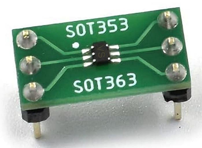

As usual, I whipped up a quick-and-dirty breadboard prototype using an SMD adapter PCB (SOT-353 to DIP-6) to host the core chip (Figure 3). I have skipped the prototype photo for now – there is only a tiny chip in play, and the breadboard layout does not offer much visual clarity anyway.
A good SMD adapter PCB gives even the tiniest chip time to shine.
Figure 3. A good SMD adapter PCB gives even the tiniest chip time to shine.

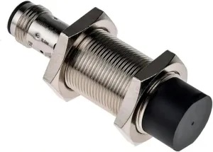

Moreover, compact inductive proximity sensors like the Omron E2B-M18KN16-M1-B1 (Figure 4) are often used as homing sensors to detect metal targets – typically a machine part or actuator – at a fixed reference point. Their non-contact operation ensures reliable, repeatable positioning with minimal wear, ideal for robotic arms, linear actuators, and CNC machines.
The Omron E2B-M18KN16-M1-B1 inductive proximity sensor supports homing applications by detecting metal targets at fixed reference points. That enables precise, contactless positioning in industrial setups.
Figure 4. The Omron E2B-M18KN16-M1-B1 inductive proximity sensor supports
