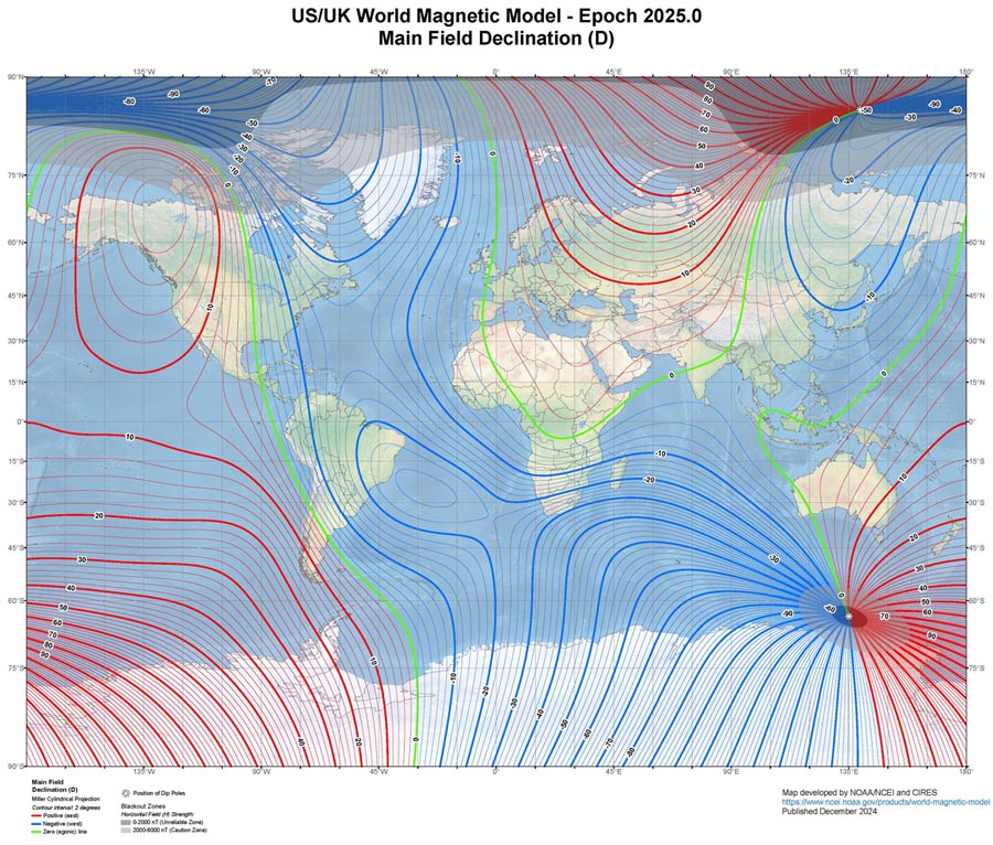

The needed magnetic map is readily available. The World Magnetic Model (WMM) [Ref. 1] from the United States National Centers for Environmental Information (NCEI) complied data with other countries. It’s the standard model for navigation, attitude, and heading referencing systems that use the geomagnetic field (Figure 1). The WMM is also used for civilian applications, including navigation and heading systems.
World Magnetic Model is standard for the Earth's magnetic field; other models and more details are available. Source: United States National Geospatial-Intelligence Agency and the United Kingdom Defence Geographic Centre.
Figure 1. World Magnetic Model is standard for the Earth’s magnetic field; other models and more details are available.
NCEI also developed the World Magnetic Model High Resolution (WMMHR) [Ref. 2], an advanced magnetic field model with more comprehensive data on the geomagnetic fields than the original World Magnetic Model. There are also privately-generated magnetic maps for highly localized areas.

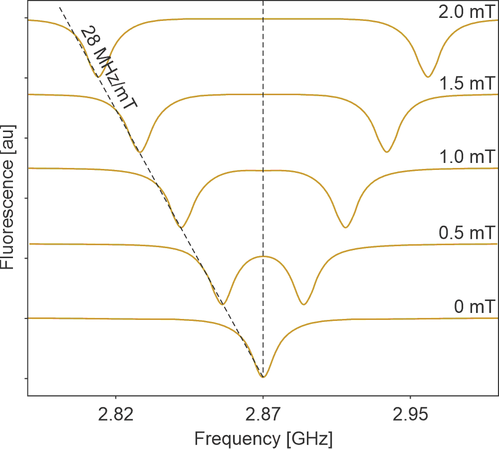

That’s why there is so much interest in quantum magnetometers based on nitrogen-vacancy (NV) centers in diamonds as perhaps the ultimate magnetic sensor. One source cites the present NV sensitivity, which is characterized by the gyromagnetic ratio as 28 GHz/tesla (T), which means it’s very sensitive to magnetic fields (Figure 2).
This sensitivity graph and its sharp slope shows the performance of an NV-center implementation. Source: QZabre.
Figure 2. This sensitivity graph and its sharp slope shows the performance
They can measure the field with precision down to one-millionth of the Earth’s weak magnetic field of approximately 25 to 65 microteslas (µT). Furthermore, the stability of their quantum reference enables drift-free measurements, eliminating the need for constant calibration and recalibration and making comparison with more reliable data sets.

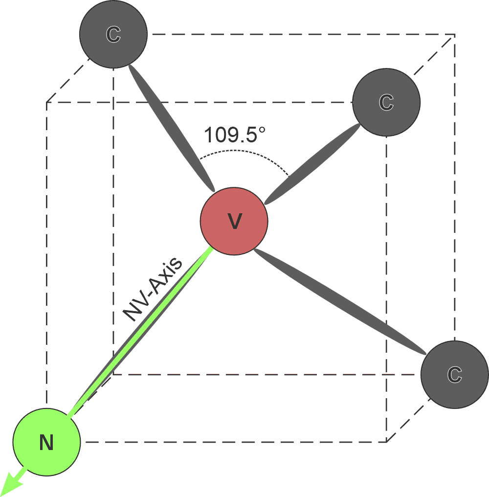

How does the NV center work? I’d like to say “in simplified terms, this is how” but that’s not possible. It’s inherently a very sophisticated story. However, in somewhat simplified terms, an NV center is a “point defect” in a lab-gown diamond lattice, in which a nitrogen atom replaces a carbon atom adjacent to a vacancy or empty lattice site in the crystal-lattice structure.
This aberration results in a two-electron spin system with unique quantum properties that can be optically initiated by a suitable laser and then interrogated, also by a laser (Figure 3).
This simplified schematic drawing shows the physical situation of the NV principle. Source: Integrated Optics
Figure 3. This simplified schematic drawing shows the physical situation
NV centers are well suited for magnetometry because of their quantum mechanical spin-1 property, which includes three energy levels: ms = 0, ±1. These energy levels are sensitive to the local magnetic field via the Zeeman effect, especially along the NV axis.
Visible (green) laser excitation polarizes the spin system and results in red light emission (photoluminescence); the intensity of this photoluminescence depends on the spin state. By applying microwave laser energy at resonant frequencies corresponding to the spin transitions, the fluorescence intensity dips. This action provides a means to detect magnetic fields via optically detected magnetic resonance. You’ve got all that, right?
As a result of the tetrahedral symmetry of the lattice, a diamond crystal typically contains NV centers in four orientations. With appropriate signal processing and a carefully applied bias-magnetic field, each orientation can be resolved, enabling full vector magnetometry.

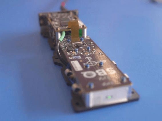

Is this advanced technique just a promising laboratory development? No, these NV systems are available and are used in a variety of mining and space-based magnetic-mapping projects (Figure 4). Among the vendors are Integrated Optics, SBQuantum, SandboxAQ, Leidos, Frequency Electronics, and QZabre.
This NV-center magnetic-sensing unit is complete and ready to use. Source: SBQuantum.
Figure 4. This NV-center magnetic-sensing unit is complete and ready to use.
Source: SBQuantum.
