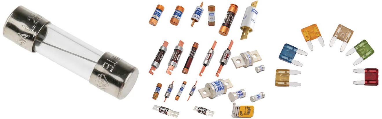

Current-handling ranges of fuses that most engineers encounter span a fraction of an amp to tens of amps. They come in myriad packages, ranging from the classic 3AG to larger cartridges, as well as blade style used in many cars, Figure 1.
High rupture capacity fuses: same idea, different reality
Figure 1. Fuses are available with different current ratings, of course, but also countless packages, including
the 3AG glass cylinder, ceramic cartridges of various sizes, and the automotive “blade” style.
But then I started to wonder: How do they make fuses for hundreds of amps? What’s their packaging? Do the fuses simply get proportionally larger as the current goes to those levels?

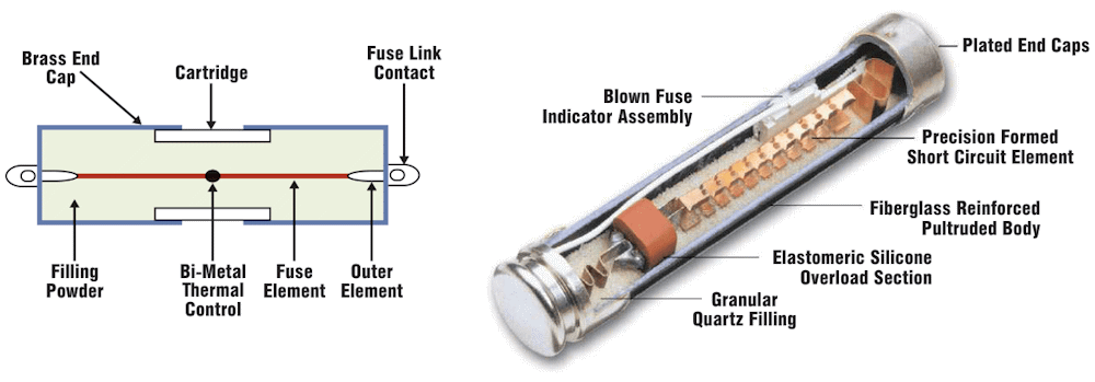

I looked into it, and I found there’s a large subclass of thermal fuses dubbed “high rupturing capacity” (HRC) fuses which may be bigger but otherwise look like regular fuses on the outside, yet have an invisible, inside twist: they are filled with sand (silica) or other material, Figure 2.
(left) The HRC fuse features a filler, usually sand; (right) the actual internal construction is more complicated, as shown by this one version (there are others, as well).
Figure 2. (left) The HRC fuse features a filler, usually sand; (right) the actual internal construction is more complicated,
The main design elements that differentiate an HRC fuse from a lower-current conventional fuse – called a low breaking capacity (LBC) fuse – are:
  • A heat-resistant, strong outer-fuse body, usually constructed from ceramic or fiberglass; LBC devices instead often have glass enclosures which are more likely to fragment when fusing action is initiated and the overload current is high.
  • The cavity inside the fuse body is filled with fine silica sand or quartz to absorb the heat and energy of an over-current. In some cases, other materials such as powdered chalk, plaster of paris, or marble dust are used, but purified sand is most common.
  • The metal caps or tags are solidly attached to the fuse body to create an air-tight seal to prevent any energy escaping in the event of an overload. ​​

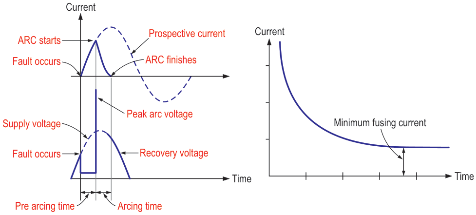

But in the reality of the high-current world, that sort of simplistic thinking is misguided and even dangerous. The purpose of sand in the fuse is primarily to act as a heat-absorbing medium and to prevent the arc from continuing once the fuse element melts, Figure 3. That allows the fuse to safely interrupt very high fault currents (often several thousand amps) without causing damage to the fuse holder or surrounding equipment.
The current versus time characterization of the HRC fuse has some interesting transitions and jumps.
Figure 3. The current versus time characterization of the HRC fuse has some interesting transitions and jumps.
The sand or other filler in these fuses plays multiple roles:
  • Cooling: When the fuse element melts due to excessive current, the sand absorbs heat, helping to cool the area and prevent fire or damage to surrounding components.
  • Arc suppression: If a fuse blows, it can create an electrical arc. The sand helps to extinguish this arc by absorbing energy and providing a medium in which the arc can dissipate safely.
  • Isolation: The sand can help to isolate the molten metal of the fuse element, preventing it from causing further short circuits or damage.
  • Enhanced safety: By reducing the risk of arcing and overheating, sand contributes to the overall safety and reliability of the fuse.
In short: in an ordinary fuse – a length of exposed wire – the wire will melt and thus break the circuit; so far, so good. However, if a large current is flowing, the wire will also partially vaporize, and permit an arc to be formed. This arc may not be quenched even by the AC zero-volt crossing (and certainly won’t be for a DC circuit) but can continue for many cycles. The sand in the HRC fuse prevents the arc from forming, allowing the circuit to be opened safely and remain so.
