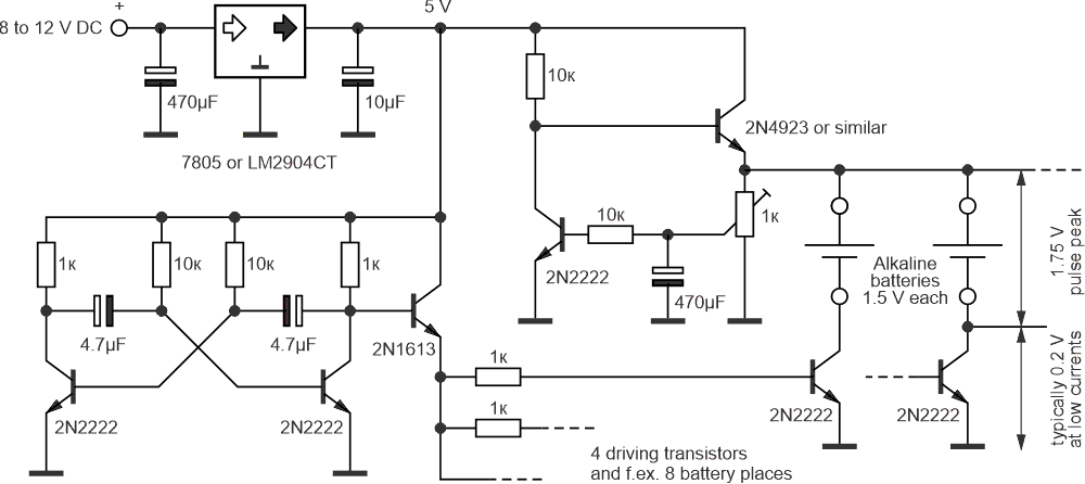

The schematic
The schematic is rather trivial (Fig. 1). A voltage regulator brings down a supply voltage (which might be from a car battery) to 5 V. An additional built-up voltage regulator generates an adjustable voltage of 1.95 V. The reason why to use two voltage levels is to distribute the heat losses better, and to have the final voltage more stable. But if your power supply outputs a stable 4 to 6 V, you can omit the 7805.
The schematic diagram.
Figure 1. The schematic diagram.
An oscillator generates roughly 10 Hz with symmetric impulse/pause ratio. This signal is fed to the transistors below the batteries and switches them to the regeneration voltage. So this is “charging” with pulsed current. In some publications also reflex charging is recommended, but it works equally well with just having a “relax” time instead of a reflex time (inverted charge, short-time load). The impulse/pause ratio is 1:1, or the impulse/period time is 50%. This is conservative, as some publications use longer charge, less relax time.

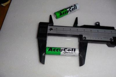

Length testing
This seems to be a new idea. Measure the length before and after regenerating (Fig 2). If you use a metal caliper, put a piece of thin paper between, else you make a short-circuit. Increased length indicates that the minus-lid is being pressed out and the risk of leakage is rather high. Also, if the minus-lid becomes spherical, this indicates some danger. In another discussion in this forum, someone proposed to let the batteries jump back from a hard surface. I guess that this correlates with a belly shaped lid in combination with internal gas pressure, making something like a football structure. Springy cells = bad and non-springy = good.
Measuring the length of the battery.
Figure 2. Measuring the length of the battery.

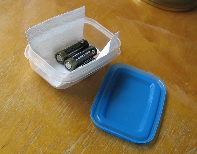

Battery quarantine
I put the batteries on a piece of tissue for a week (Fig. 3). If there is no leakage, they come into the refrigerator for storage, but for safety they are stored in tissue in a plastic bin.
Battery quarantine.
Figure 3. Battery quarantine.

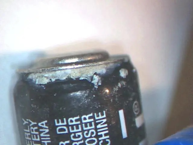

Can it explode?
Unfortunately, not. You need to mix up your own gunpowder smiley. The worst what happens in case of overcharging, is, that the minus-lid comes slowly out and the electrolyte drips out (Fig. 4).
Electrolyte leakage.
Figure 4. Electrolyte leakage.
