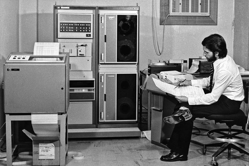

They were typically tied to printer terminals like the venerable Teletype or display terminals, often referred to as CRTs due to their cathode ray tube (CRT) main display like the Hewlett-Packard (HP) 2116 (Fig. 1). Storage devices included tape drives and hard-disk drives.
The Hewlett-Packard 2116 is a large, timesharing minicomputer shown here with a printer, tape drives, disk drives, and terminal.
Figure 1. The Hewlett-Packard 2116 is a large, timesharing minicomputer shown here

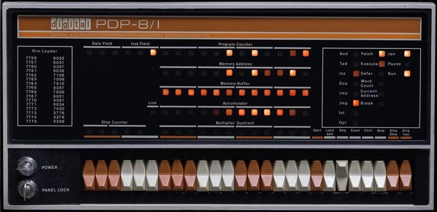

Minicomputers came in a range of sizes and architectures from many companies. Digital Equipment Corporation (DEC) was one of those companies, and the 12-bit PDP-8 (Fig. 2) was one of its more popular models. DEC also offered large-scale systems, including the 32-bit VAX series. DEC was eventually acquired by Compaq and then Hewlett-Packard.
The Digital Equipment Corporation (DEC) PDP-8 was a 12-bit minicomputer that initially launched in 1965.
Figure 2. The Digital Equipment Corporation (DEC) PDP-8 was a 12-bit minicomputer

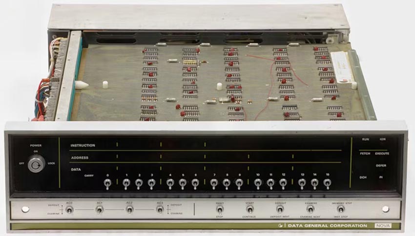

The Data General Nova line of 16-bit minicomputers found a home in scientific and industrial settings (Fig. 3). The base system fit into a 3U rack and the register contents could be displayed on the front panel with switches to enter data typically for initial booting. Punched paper tape or magnetic tape often contained the second-stage loader that in turn booted applications directly or in an operating system.
The Data General Nova series was a 16-bit minicomputer. It was popular in science laboratories and engineering environments.
Figure 3. The Data General Nova series was a 16-bit minicomputer. It was popular

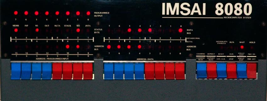

What initially did in the minicomputer was the microcomputer and the single (usually) chip microprocessor, with the Intel 8008 being one of the opening shots. The Intel 8080 was the next and most popular step, showing up in platforms like the IMSAI 8080 (Fig. 4).
The IMSAI 8080 was a clone of the MITS Altair 8800 that was based on the Intel 8-bit microcontroller.
Figure 4. The IMSAI 8080 was a clone of the MITS Altair 8800 that was based
This class of hobbyist microcomputers and eventually commercial products was based on defacto standards like the S-100 bus (eventually defined as IEEE 696-1983) and operating systems such as Digital Research's CP/M, which eventially led to MS-DOS for the IBM PC.

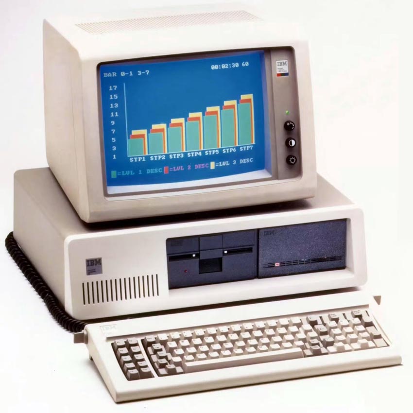

While microcomputers like the IMSAI 8080 brought minicomputer functionality to a lower price point, the IBM Personal Computer (PC) turned these platforms from an expensive shared resource to a personal-computer system (Fig. 5). The 16-bit Intel 8088 and 8086 were behind these platforms, along with the PC Disk Operating System (PCDOS or simply DOS) and its Microsoft counterpart, MS-DOS.
The IBM PC XT added a hard drive to the PC's dual floppy-disk drives.
Figure 5. The IBM PC XT added a hard drive to the PC's dual floppy-disk drives.
Graphics on the PC was useful but primitive compared to today's platforms. Improved graphics and faster and better hardware allow Microsoft Windows to dominate the desktop and office space.
The cloning of the IBM PC BIOS (Basic Input/Output System) – originally developed by Gary Kildall for CP/M systems – and the ability to use de facto Industry Standard Architecture (ISA) expansion boards made all the difference. IBM PC clones expanded the market, and hardware and software vendors had a platform to target.

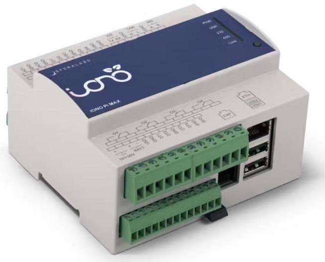

Not surprisingly, the embedded commercial and industrial uses of minicomputers was replaced by more compact microcontroller- and microprocessor-based solutions. Today, we have platforms like the Raspberry Pi and systems such as Sfera Labs' Iona Pi Max based on a Raspberry Pi Compute Module – and that's only one of the processors within the systems (Fig. 6).
Sfera Labs' Iona Pi Max programmable logic controllers (PLCs) are based on a Raspberry Pi Computer Module.
Figure 6. Sfera Labs' Iona Pi Max programmable logic controllers (PLCs)
The Raspberry Pi family highlights the massive advancement in computing power and reduction in size and power requirements compared to minicomputers. The Iona Pi Max has its own internal expansion and can run standard operating systems like Linux. Developers have access to an array of software tools including multiple programming languages and middleware frameworks, as well as amazing communication options using standards like wired Ethernet and wireless communication.

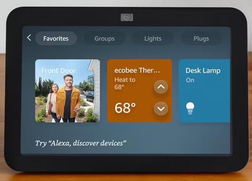

Nowadays, people don't think twice about folding smartphones with terabytes of non-volatile storage, multiple cameras, built-in GPS, NFC support, and AI acceleration in the palm of their hands. Devices like Amazon's Echo Show (Fig. 7) provide voice interaction courtesy of Alexa. It represents just one of many systems having such capability.
Amazon's Alexa-based Echo Show highlights the massive changes from minicomputers to today's cloud-based, AI-enhanced, vioce-operated edge devices.
Figure 7. Amazon's Alexa-based Echo Show highlights the massive changes from minicomputers
