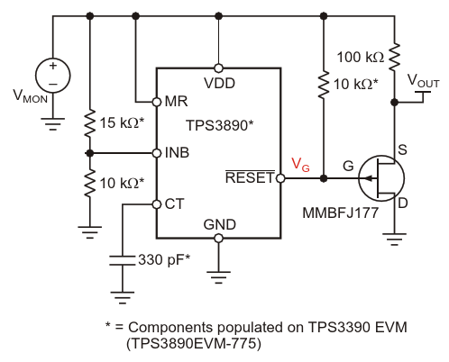

Figure 4. Adding a JFET to remove output voltage rise with low V
DD
