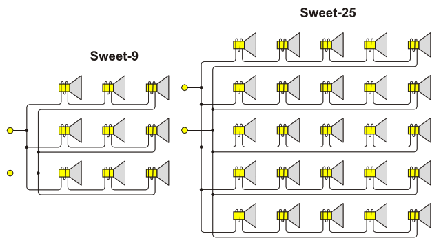

One could make a …
One could make a three-by-three or five-by-five array and achieve much the same results

Speaker system handles high power without distortion
Figure 1. The 16 speakers could be interconnected so that their composite impedance at the two terminals would be the same as the impedances of the individual speakers themselves
Figure 2. One could make a three-by-three or five-by-five array and achieve much the same results
