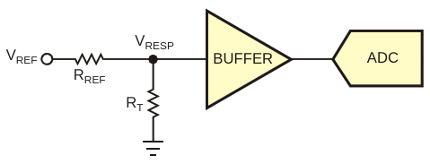

The resistive-divider topology provides …
The resistive-divider topology provides a lower cost alternative to a current source and a precision resistor for calibration
Accurately measure resistance with less-than-perfect components
Figure 1
8 Kb
Figure 1. The resistive-divider topology provides a lower cost alternative to a current source and a precision resistor for calibration
Figure 2. Remove most gain and offset errors using two measurements and a ratio calculation
Figure 3. Extend the idea to handle multiple sensors and signal paths, using multiplexing through a single buffer and A/D converter
