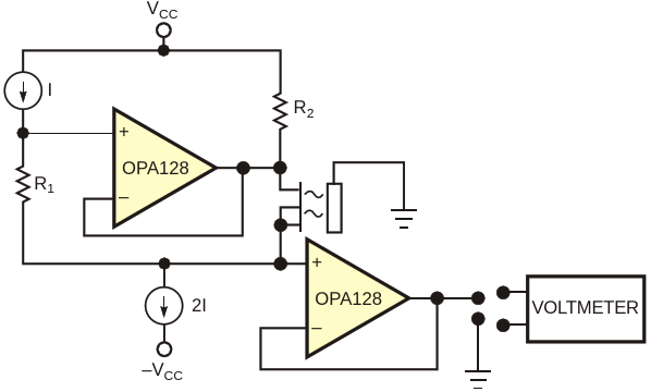

A constant-current driver provides the basis for a chemical-concentration test system
Casans, D Ramirez, AE Navarro
Circuit provides constant current for ISFETs/MEMFETs

Figure 1. A constant-current driver provides the basis for a chemical-concentration test system
Figure 2. The gate-source voltage shows good correlation with the concentration of [H
1
] ions
Figure 3. The gate-source voltage of an ISFET shifts with the degree of acidity
