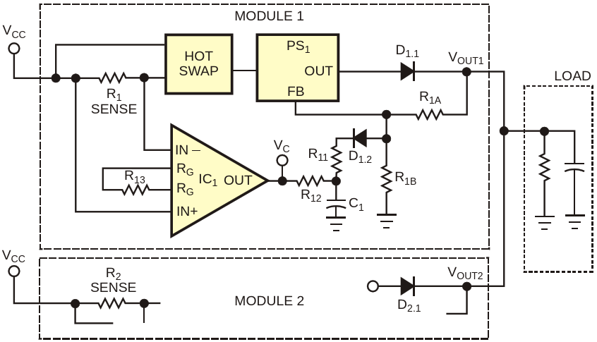

The addition of an instrumentation amplifier and a few passive components provides sag- and glitch-free redundant performance

Hot-swap structure offers improved redundancy
Figure 1. A standard redundant configuration of power supply modules uses ORing diodes at the outputs
Figure 3. The addition of an instrumentation amplifier and a few passive components provides sag- and glitch-free redundant performance
