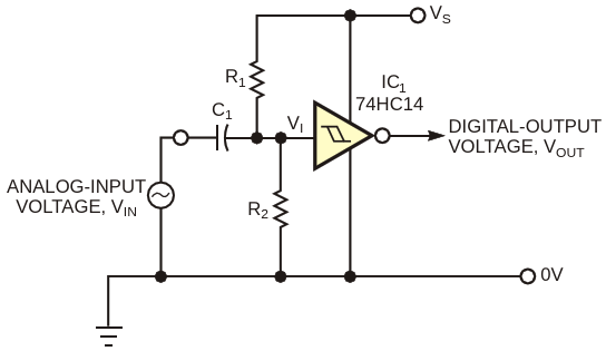

This Schmitt-trigger circuit is useful for converting an ac signal to digital form

Resistor network extends Schmitt trigger's reach

Figure 1. This Schmitt-trigger circuit is useful for converting an ac signal to digital form
Figure 2. Eliminating the input capacitor avoids problems with asymmetrical input waveforms
Figure 3. The potentiometer networks solve the problem of large spreads in component values
