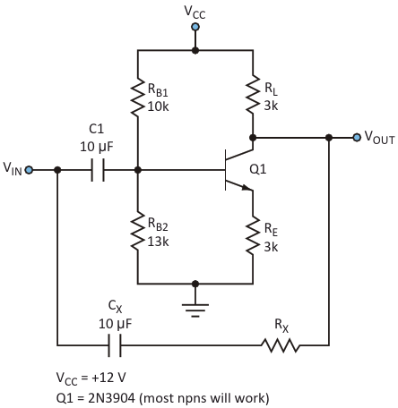

By taking advantage of a saturated bipolar transistor's "gain reversal" phenomenon, this circuit can perform full-wave signal rectification using only one transistor
AuthorsDavid Albean
Main DocumentArticle «Full-Wave Signal Rectifier Uses Just One Transistor»
DescriptionFigure 1
File Format / SizePDF / 26 Kb
By taking advantage of a saturated bipolar transistor's gain reversal phenomenon, this circuit can perform full-wave signal rectification using only one transistor
