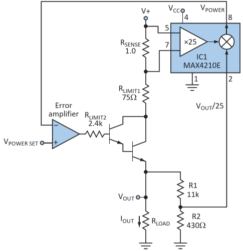

The feedback loop in the power regulator ensures that the power to the varying load remains relatively constant

Figure 1. A typical feedback loop for a voltage regulator can be adapted to create a power regulator for a load with varying impedance
Figure 2. The feedback loop in the power regulator ensures that the power to the varying load remains relatively constant
Figure 3. The power output for the circuit in Figure 2 remains well regulated for a wide range of loads and for various values of VPOWER_SET, which range from 0.0021 (bottom) to 0.0300 V (top).
