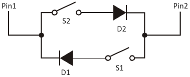

Starting with this basic configuration, the improved switch interface technique can be scaled as needed

Novel Switch Interface Scheme Reduces Microprocessor Pin Count
Figure 1. Starting with this basic configuration, the improved switch interface technique can be scaled as needed
Figure 2. Extending the basic configuration, this circuit interfaces 12 switches using only four I/O pins of a microcontroller
