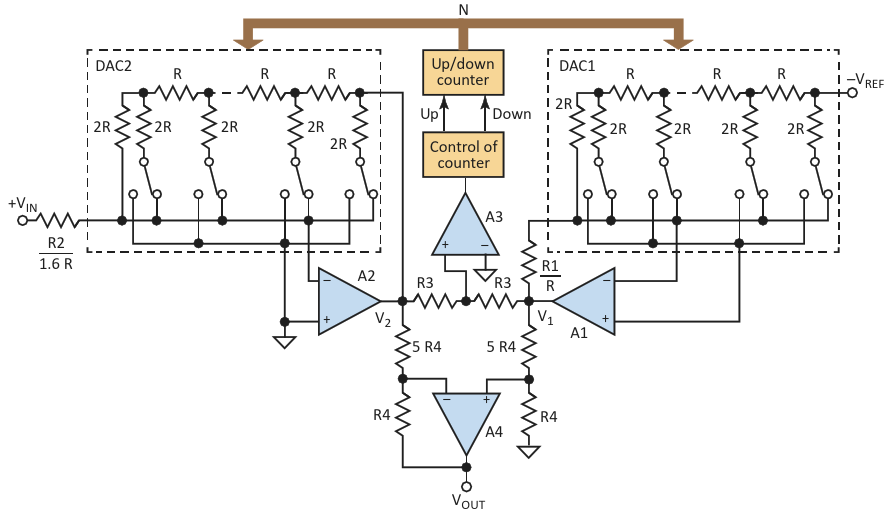

The example circuit uses only four switches within each DAC for clarity, but the number of switches can be increased for improved accuracy
Yakov Velikson
Added ADC Improves Analog Square-Root Extraction Accuracy
Figure 2
75 Kb
Figure 1. The architecture of enhanced analog square-root extraction circuit consists of three parts that feedback to reduce error
Figure 2. The example circuit uses only four switches within each DAC for clarity, but the number of switches can be increased for improved accuracy
