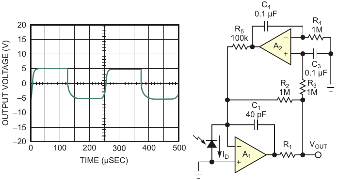

A dc-restoration circuit expands …
A dc-restoration circuit expands the output range of a transimpedance amplifier across both quadrants
Bonnie Baker
Photosensing with ambient background
Figure 2
14 Kb
Figure 1. The output range of a transimpedance amplifier spans only one quadrant
Figure 2. A dc-restoration circuit expands the output range of a transimpedance amplifier across both quadrants
