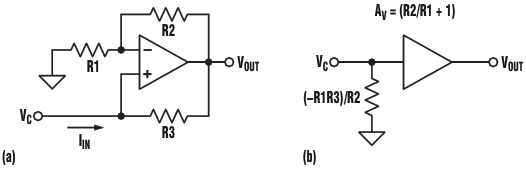

In the circuit in Figure 1, the right-hand side (a) can be simplified to an equivalent circuit (b)

Consider the "Deboo" integrator for unipolar noninverting designs

Figure 1. The "Deboo" integrator consists of a Howland current source and a capacitive load
Figure 2. In the circuit in Figure 1, the right-hand side (a) can be simplified to an equivalent circuit (b)
