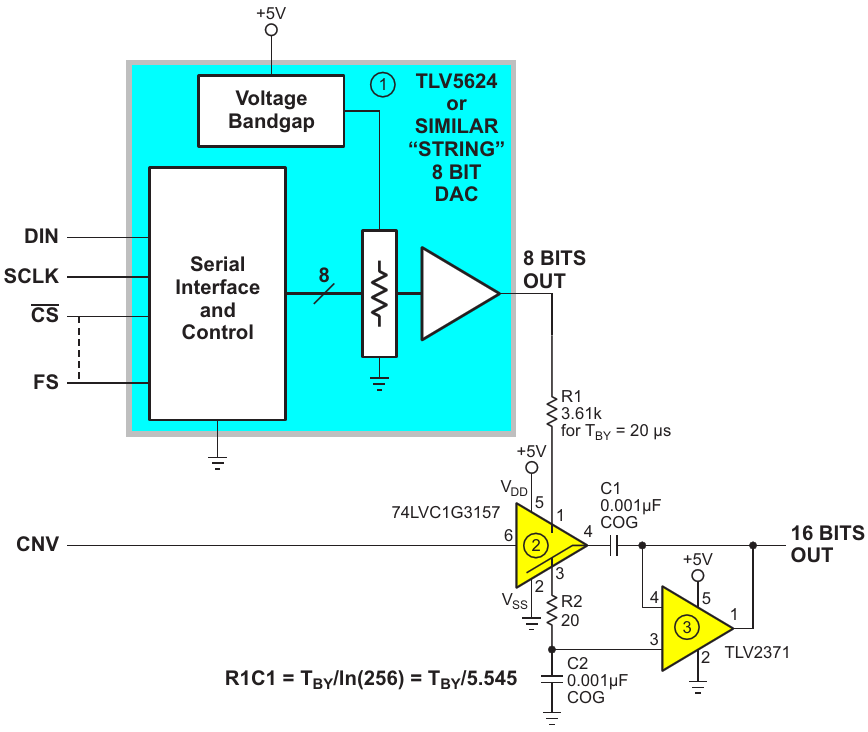

The Shannon decoder principle applied to extending 8-bit DAC resolution
Stephen Woodward
Squeeze extra resolution from an 8-bit DAC with Shannon decoder idea
Figure 4
19 Kb
Figure 3. The Shannon decoder dynamic DAC
Figure 4. The Shannon decoder principle applied to extending 8-bit DAC resolution
Figure 5. The Shannon conversion sequence
