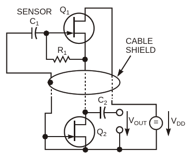

The second JFET, Q
2
The second JFET, Q
2
, in this circuit replaces R
2
in the circuit of Figure 1

Figure 1. The JFET in this circuit effectively multiplies the value of R
1
Figure 2. The second JFET, Q
2
2
