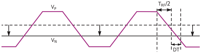

By exploiting the rise and fall time of a signal and manipulating a dc bias voltage, you can control the duty cycle of a CML signal

Figure 1. This circuit can make slight adjustments to the duty cycle you apply to a CML input
Figure 2. By exploiting the rise and fall time of a signal and manipulating a dc bias voltage, you can control the duty cycle of a CML signal
