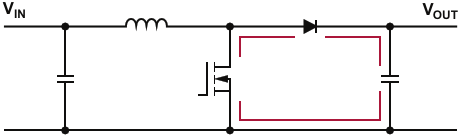

A schematic of a step-up switching regulator and paths with rapidly changing currents shown in red

The golden rule of board layout for switch-mode power supplies

Figure 2. A schematic of a step-down switching regulator and paths with rapidly changing currents shown in red
Figure 3. A schematic of a step-up switching regulator and paths with rapidly changing currents shown in red
