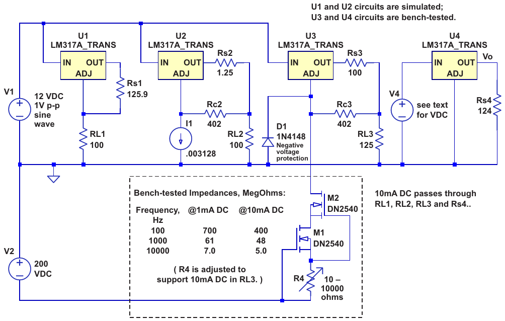

A series of LM317 circuits investigated in simulation and on the test bench for suitability as a current source

Figure 1. A series of LM317 circuits investigated in simulation and on the test bench for suitability as a current source
