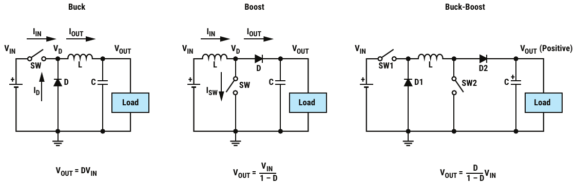

Common SMPS topologies and their output formulas

Analysis of switch-mode power supply and rectification: Inductor violations
Figure 1. Common SMPS topologies and their output formulas
