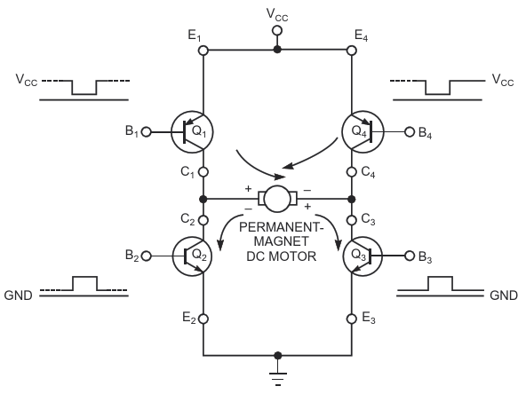

In an H-bridge output-driver …
In an H-bridge output-driver stage, diagonally opposed transistor pairs conduct to energizea dc motor. The circuit requires four control signals

Microcontroller drives H bridge to power a permanent-magnet dc motor
Figure 1
27 Kb
Figure 1. In an H-bridge output-driver stage, diagonally opposed transistor pairs conduct to energizea dc motor. The circuit requires four control signals
Figure 2. Improved H-bridge-driver circuit uses transistors in complementary pairs and requires only two low-level control signals
