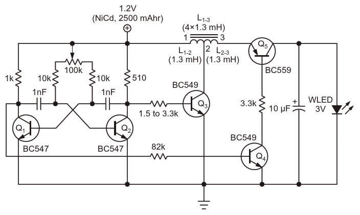

An inductive voltage booster …
An inductive voltage booster powers the white LED

Pocket white-LED torch is power efficient
Figure 1. An inductive voltage booster powers the white LED
