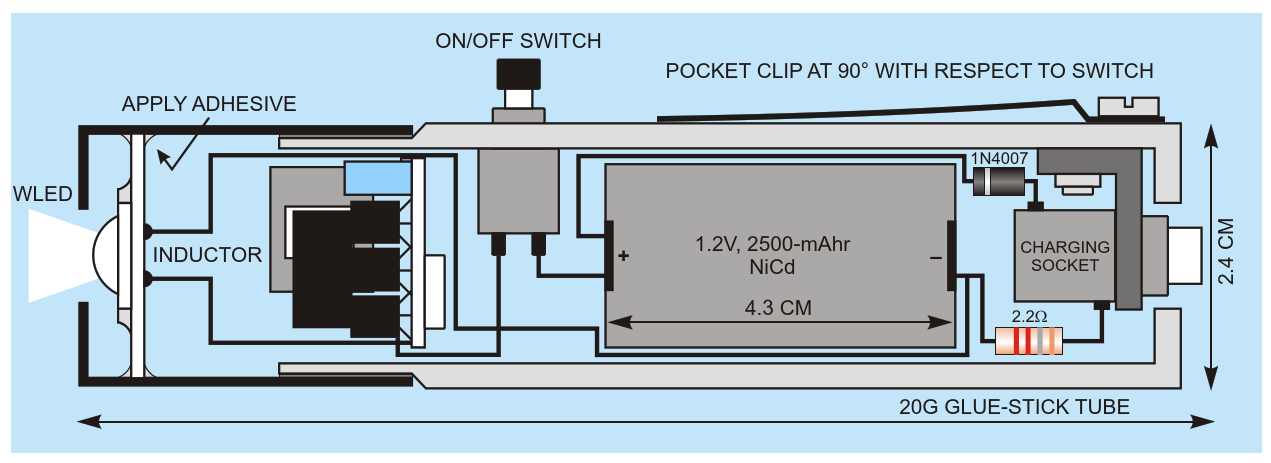

The white-LED torch can …
The white-LED torch can be assembled inside an empty glue-stick tube
Raju Baddi
Pocket white-LED torch is power efficient
Figure 3
33 Kb
Figure 1. An inductive voltage booster powers the white LED
Figure 2. The circuit's components can be assembled onto the two sides of a circular general-purpose board: Connections on the lower surface have been mirrored (a); from the top, component placement is shown in white, and connections are shown in green (b)
Figure 3. The white-LED torch can be assembled inside an empty glue-stick tube
