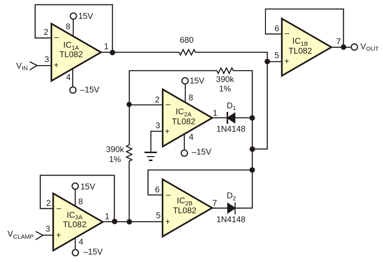

This circuit provides adjustable …
This circuit provides adjustable clamping over the range of ±1 to ±10 V
Circuit forms adjustable bipolar clamp
Figure 1
20 Kb
Figure 1. This circuit provides adjustable clamping over the range of ±1 to ±10 V
Figure 2. With V
CLAMP
set at -5 V, the output clamps firmly at ±5 V
