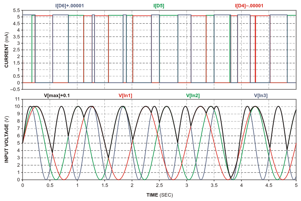

Three sine waves of different frequencies provide input voltages (lower traces) that evoke the greatest- of-three response in the current through R2 (top trace, in which colored horizontal segments match the largest inputs)

Three sine waves of different frequencies provide input voltages (lower traces) that evoke the greatest- of-three response in the current through R sub 2 /sub  (top trace, in which colored horizontal segments match the largest inputs)
