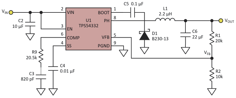

The output voltage in a conventional dc-dc buck converter is fixed and depends on the resistor divider, R1/R2

Figure 1. The output voltage in a conventional dc-dc buck converter is fixed and depends on the resistor divider, R1/R2
