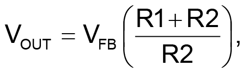

In a conventional dc-dc buck converter, VOUT is:
  (1)
so VOUT is fixed by the values of R1 and R2 (Fig. 1).
The output voltage in a conventional dc-dc buck converter is fixed and depends on the resistor divider, R1/R2.

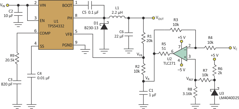

The added circuitry in Figure 2 enables users to control the same dc-dc converter's output voltage using VC.
The added circuitry in this version of the DC-DC converter permits control of VOUT by varying a control voltage, VC.
Figure 2. The added circuitry in this version of the DC-DC converter permits control of VOUT by varying

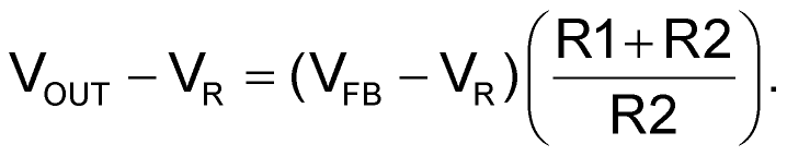

In this case, R2 is not connected to the ground but, rather, to VR. Equation 1 then becomes:
  (2)
Since R1 = 20 kΩ and R2 = 10 kΩ, Equation 2 can be simplified to:
  (3)
or:
  (4)
R3 and R4 have the same value, 10 kΩ, so amplifier U2's output voltage is:
  (5)
where VREF is the reference voltage generated by U3 after resistor divider R7/R8.
Combining Equation 4 and Equation 5:
  (6)
To simplify Equation 6, choose components that make:
  (7)
Then Equation 6 becomes:
  (8)
