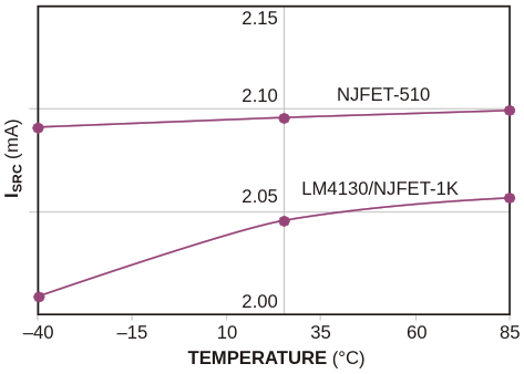

The composite configuration also …
The composite configuration also offers a slight improvement in the variation of I

Voltage reference improves JFET
Figure 1. The common JFET transistor current source (a) has an average output impedance. A composite voltage reference and JFET circuit (b) features higher output impedance, high accuracy, and low temperature drift

Figure 3. The composite configuration also offers a slight improvement in the variation of I
SRC
with a change in temperature
