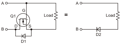

The circuit protects the …
The circuit protects the load against reversed battery using an N-channel MOSFET

Polarity-correcting circuit protects battery-powered devices
Figure 1. This circuit protects the load against a reversed battery using a P-channel MOSFET
Figure 2. The circuit protects the load against reversed battery using an N-channel MOSFET
Figure 3. This circuit provides power to the load with any installation of the battery
Figure 4. Protection of the gate-source junctions of the MOSFETs
