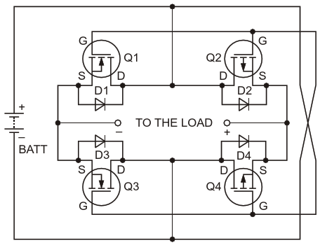

This circuit provides power …
This circuit provides power to the load with any installation of the battery

Figure 3. This circuit provides power to the load with any installation of the battery
