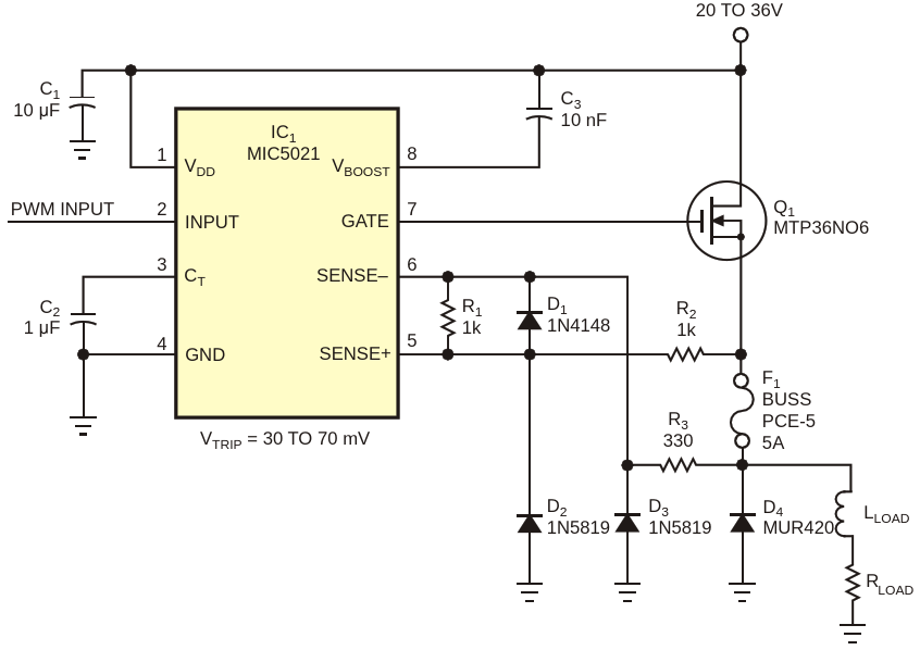

A fuse does double …
A fuse does double duty as a protection device and a current-sensing resistor
Eugene Kaplounovski
PWM circuit uses fuse to sense current
Figure 1
25 Kb
Figure 1. A fuse does double duty as a protection device and a current-sensing resistor
Figure 2. Self-heating causes a positive temperature coefficient of resistance in the fuse in Figure 1
