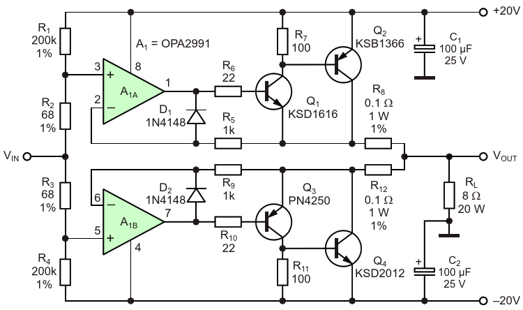

This current booster circuit delivers up to 20 W of power and exhibits a well-defined temperature- independent quiescent current

Class AB 20-W current booster is insensitive to temperature variations

Figure 2. This current booster circuit delivers up to 20 W of power and exhibits a well-defined temperature- independent quiescent current
