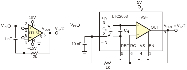

Practical implementations of the circuit in Figure 1 use the LT1167 (a) and the LTC2053 (b)

Amplifiers perform precision divide-by-2 circuit
Figure 1. An instrumentation amplifier makes a simple divide-by-2 circuit
Figure 2. Practical implementations of the circuit in Figure 1 use the LT1167 (a) and the LTC2053 (b)
