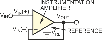

The classic implementation of a voltage-halving circuit uses two equal-value resistors. Using 1% resistors provides a divider output with 2% accuracy. For most applications, this performance is cost-effective and more than adequate. However, when you need extreme precision, this approach requires correspondingly accurate resistors and can become expensive. Putting feedback around a finite-gain instrumentation amplifier yields a divide-by-2 circuit with the added benefit of a buffered output (Figure 1).
An instrumentation amplifier makes a simple divide-by-2 circuit.
Figure 1. An instrumentation amplifier makes a simple
The operation of the circuit is straightforward. The instrumentation amplifier has unity gain, so the voltage it sees across its inputs appears between VREF and VOUT:
VOUT – VREF = VIN(+) – VIN(–).
But, considering the circuit in Figure 1, note that VOUT = VIN(–), and VREF =  0. Substituting in the first equation, you obtain
VOUT = VIN(+) – VOUT,
2VOUT = VIN(+),
or
VOUT =1/2 VIN(+).
Thus, you have a divide-by-2 circuit. One of the interesting features of this approach is that the input and the output offsets of the instrumentation amplifier are divided by 2 as well.
