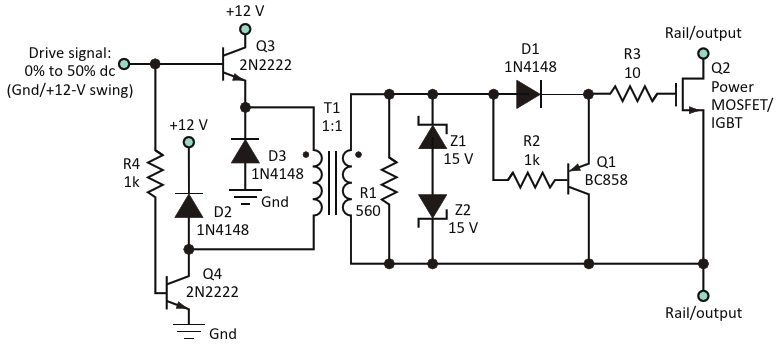

This gate drive transformer …
This gate drive transformer circuit provides the MOSFET drive signals ranging from 50% down to 0% while maintaining a fast turn-off time

Gate Drive Transformer Circuit Maintains Fast Turn-Off Time
Figure 1
35 Kb
Figure 1. This gate drive transformer circuit provides the MOSFET drive signals ranging from 50% down to 0% while maintaining a fast turn-off time
