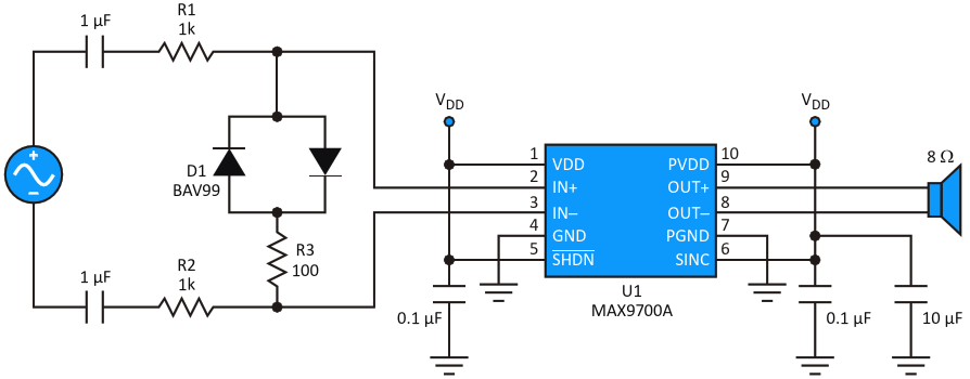

A small-signal diode network prevents clipping by limiting an amplifier's output voltage
John Guy
Simple Additions To Audio Amplifier Prevent Clipping At Higher Inputs
Figure 1
30 Kb
Figure 1. A small-signal diode network prevents clipping by limiting an amplifier's output voltage
