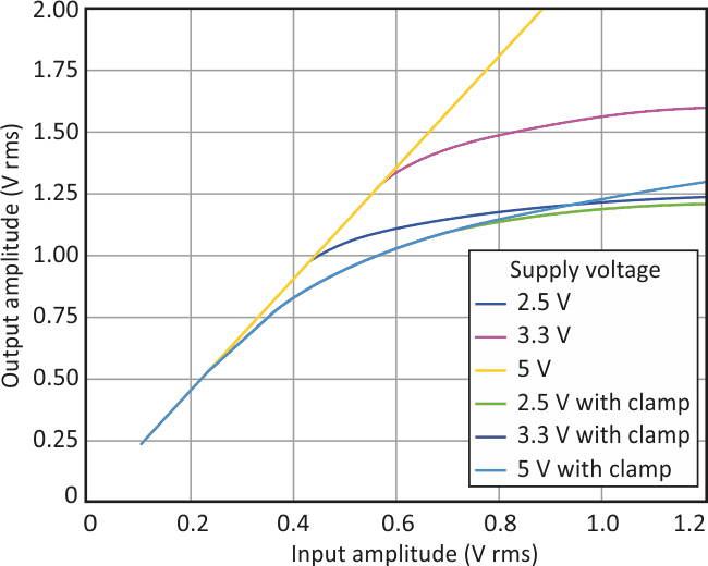

During normal operation, the incoming audio signal sees little attenuation by the diode network, and the high input impedance of U1 prevents attenuation due to the higher source impedance. As input amplitudes increase, the transfer function shifts (Fig. 2).
Signal attenuation by the simple diode network causes a nonlinear transfer of the higher-amplitude inputs.
Figure 2. Signal attenuation by the simple diode network causes a nonlinear transfer
As you can see, the output tracks the input for low-level signals. Above input levels of about 0.5 V rms, there's a decrease in circuit gain. Gain compression is independent of the peak output voltage, as illustrated by the responses for various supply voltages. Note that the clamped 3.3- and 5-V inputs have the same response and are therefore superimposed. Also, the 2.5- and 3.3-V inputs show compression due to swing limits, even though no clamp is present.
