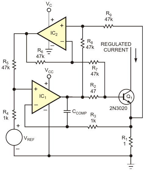

Adding base-current error compensation …
Adding base-current error compensation improves the circuit's performance. Using perfectly matched resistors simplifies the output-current equation to I

Error compensation improves bipolar-current sinks
Figure 1. This typical quickly responding constant-current sink uses a bipolar transistor but suffers from base-current-induced error. Its normal output current is I
OUT
= (V
REF
/R
1
) - I
B
Figure 2. Adding base-current error compensation improves the circuit's performance. Using perfectly matched resistors simplifies the output-current equation to I
OUT
= (V
REF
/R
1
Figure 3. You can further simplify the current sink's design by adding only two resistors, R
5
and R
6
, to the original in Figure 1. The output-current equation remains I
OUT
= (V
REF
/R
1
), as in Figure 2
