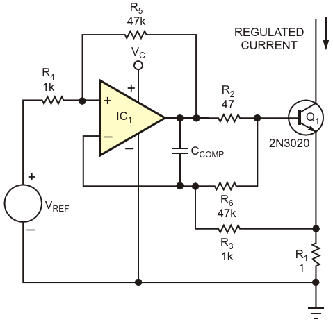

You can further simplify the current sink's design by adding only two resistors, R5 and R6, to the original in Figure 1. The output-current equation remains IOUT = (VREF/R1), as in Figure 2

You can further simplify the current sink's design by adding only two resistors, R sub 5 /sub  and R sub 6 /sub , to the original in Figure 1 The output-current equation remains I sub OUT /sub  = (V sub REF /sub /R sub 1 /sub ), as in Figure 2
