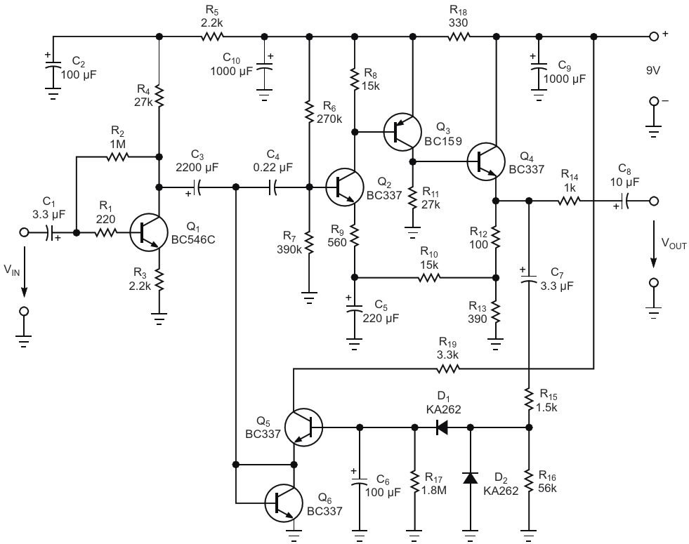

AGC amplifier features 60-dB dynamic range
Figure 3
41 Kb
Figure 1. A short-circuited bipolar transistor forms one element of a basic attenuator circuit
Figure 2. A V
I
characteristic shows the corresponding differential-resistance graph for a short-circuited BC337-16 transistor. (Note: The -16 denotes a sorted h
FE
range of 100 < h
FE
< 250.)
Figure 3. You can assemble this AGC circuit entirely from discrete components
Figure 4. The circuit's input-versus-output characteristic shows a 60-dB control range (upper trace) and total harmonic distortion well below 5% over the control range (lower trace)
