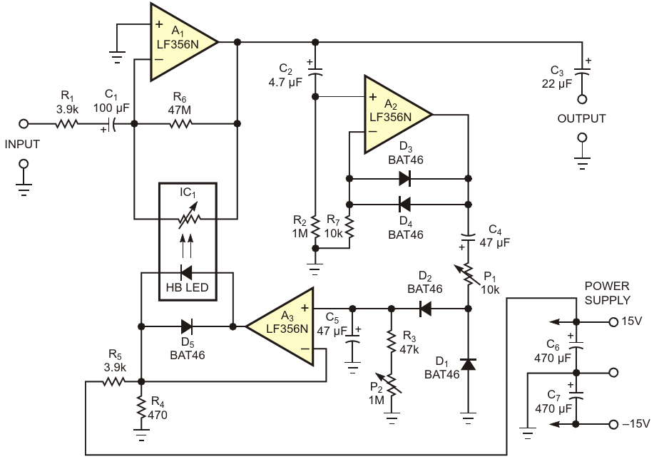

The adaptive-amplifier system has …
The adaptive-amplifier system has the optocoupler in a feedback loop
Julius Foit, Jan Novák
Photoresistor provides negative feedback to an op amp, producing a linear response
Figure 3
32 Kb
Figure 2. The optocoupler's logarithmic response in a feedback loop produces a linear amplifier response
Figure 3. The adaptive-amplifier system has the optocoupler in a feedback loop
Figure 4. The amplifier system has a constant output from 0.1 mV to 1 V-rms input
