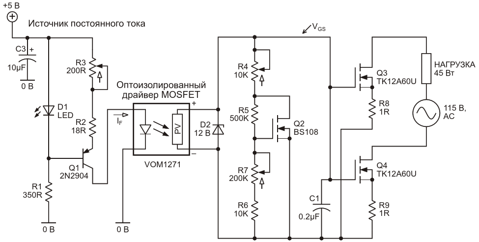

Isolated AC linear power control
Рисунок 1
30 Kb
Russian
Figure 1. AC linear power control circuit
Figure 2. Transfer characteristics of a photovoltaic coupler
Figure 3. VOM1271 forward current vs. gate-source voltage
Figure 4. Voltage waveforms across the load at various power levels
