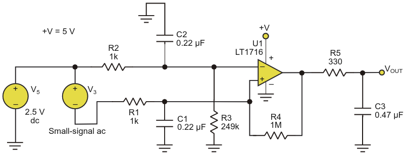

Because U1 incorporates an asymmetric output stage (weak-pull-up/strong-pull-down), the improved circuit does not require a diode, which eliminates the forward diode voltage drop
AuthorsGlen Brisebois
Main DocumentArticle «Asymmetric Output Into Capacitor Load Turns Capacitor Into Ideal Diode»
DescriptionFigure 2
File Format / SizePDF / 20 Kb
