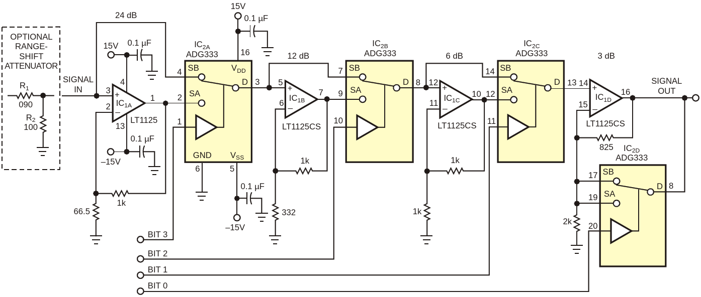

This VGA offers ultralow noise, a wide dynamic range, and high bandwidth

Circuit Yields Ultralow-Noise VGA
Figure 1. This VGA offers ultralow noise, a wide dynamic range, and high bandwidth
Figure 2. An ADC controls the gain-setting codes for the circuit in Figure 1
