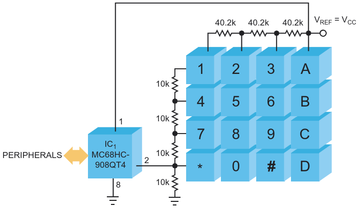

Using the microcontroller's analog reference-voltage output and ratiometric analog-to- digital conversion ensures correct encoding of the keypad

Two-wire, four-by-four-key keyboard interface saves power
Figure 1. A two-wire resistive voltage-divider interface encodes a four-row-by- four-column keypad
Figure 2. Using the microcontroller's analog reference-voltage output and ratiometric analog-to- digital conversion ensures correct encoding of the keypad
