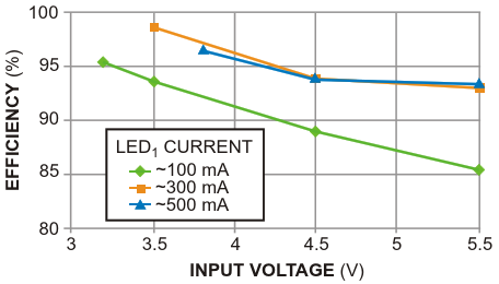

Circuit efficiency versus input …
Circuit efficiency versus input voltage shows an increase in efficiency for increasing LED current and decreasing input voltage

Switching regulator efficiently controls white-LED current
Figure 1. This circuit drives a high-current, white LED at 93% efficiency over input voltage and temperature. Potentiometer R
1
controls current through LED
1
and allows brightness adjustment. Diode D
1
provides temperature compensatio
Figure 2. Circuit efficiency versus input voltage shows an increase in efficiency for increasing LED current and decreasing input voltage
Figure 3. Current through the LED varies less than 3% over an operating- temperature range of 0 to 75 °C
