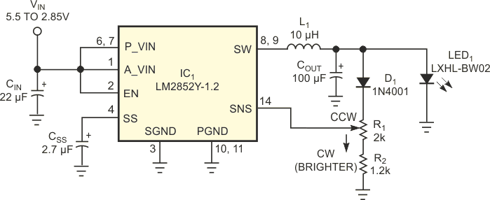

In addition, using a series resistor allows the diode's bias point and thus its brightness to fluctuate as the power-supply voltage and the ambient temperature vary. Based on LM2852 switched-mode bucking regulator, which features internal compensation and synchronous-MOSFET switches that can drive loads as large as 2 A, the circuit efficiently provides constant-current drive to a high-current LED and minimizes the effects of supply-voltage and temperature variations on the LED's brightness (Figure 1).
This circuit drives a high-current, white LED at 93% efficiency over input voltage and temperature. Potentiometer R1 controls current through LED1 and allows brightness adjustment. Diode D1 provides temperature compensation for LED1's forward-voltage drop.
Figure 1. This circuit drives a high-current, white LED at 93% efficiency over input voltage and temperature.
temperature compensation for LED1’s forward-voltage drop.
In this circuit, the LM2852 operates at efficiency of approximately 93% and directly controls a step-down-regulator topology that maintains a constant current flow through LED1, which potentiometer R1 adjusts. Current-to-voltage conversion taking place within the circuit's control loop effectively regulates the circuit's output current. In operation, the LM2852 compares its internal reference voltage with the voltage from the divider formed by D1, R1, and R2 and drives the control loop to maintain a constant 1.2 V at its voltage-sense pin. Current through the voltage divider is proportional to the current through LED1, and the ratio of the currents tracks over the circuit's operating-temperature range because D1 and LED1 exhibit approximately the same forward-voltage temperature coefficient of –2 mV/°C. Mounting D1 and LED1 next to each other on the pc board provides sufficiently close thermal coupling for temperature compensation.
With R1’s wiper fully clockwise, the current through D1 approaches 1 mA, and the current through LED1 averages approximately 500 mA. Adjusting R1 counterclockwise reduces LED1’s forward current from 500 mA to 0 A.

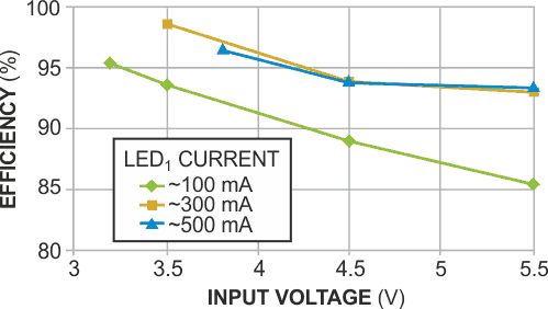

When scaling the values of R1 and R2 for a different current-loop gain, decreasing the gain impacts the circuit's conversion efficiency, and increasing the gain makes the loop more sensitive to component tolerances. To provide a remote brightness control, you can replace mechanical potentiometer R1 with a digitally programmed potentiometer. Luxeon, the manufacturer of LED1, an LXHL-BW02, specifies limits of 350-mA continuous current and 500-mA peak-pulsed current. Figure 2 shows the circuit's efficiency versus variations in input voltage. Note that the circuit's efficiency increases as input voltage decreases, which helps extend operating time in battery-powered-system applications.
Circuit efficiency versus input voltage shows an increase in efficiency for increasing LED current and decreasing input voltage.
Figure 2. Circuit efficiency versus input voltage shows an increase in efficiency
